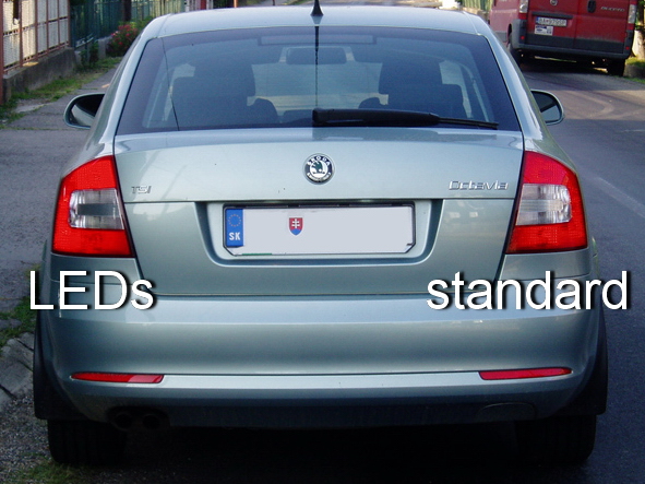

In our country we call tail light (the whole red "C shape") parking light...
And here is that "C shape" together with brake - I still think there is enough difference - I made this photo during sunny day
BTW: you are right, it is not as strong as normal bulb, but still really visible...60 m-smt bulbs are the strongest, that I could buy

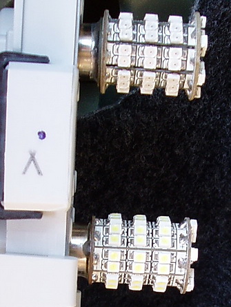

You really MUST buy red LED. White LEDs are of course stronger, but most of their light is filtered out by red lense - so in the end it is ugly pink and not as strong...
BTW: you can see, that LED tail light is even stronger and more red than standard bulb. Brakelight is about 80% of normal bulb intensity...

How long is this bulb? Im sure it's not possible to put it into reflector - because Octavia has 4 small plastic lenses in front of tail light bulbs...

should be OK, it is just 4 mm longer
